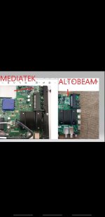

First of all, warm greetings from my side. I am trying to make a small contribution to the problem you are having. if you have problems with Wi-Fi and the others are fine, I recommend you to change the Wi-Fi module. There are two types of modules used in these mainboards: altobeam and mediatek.
    258.8 KB · Görüntüleme: 17
